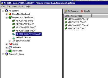

Thanks for your reply.  Yes, I have added the cable to MAX  (see image below - also tells you what AO Series device I have)
I am using 'No Trigger', so I assuming Dev1 is triggering, also going by the fact that the Dev1 Boolean goes green.  Dev2 Booleen does not go green.

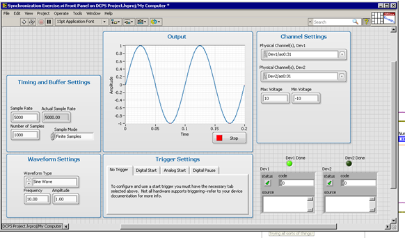

Thanks for the offer!!  Here you go,
Gretchen
Looks familiar, right?  Looks like the DAQmx Examples.

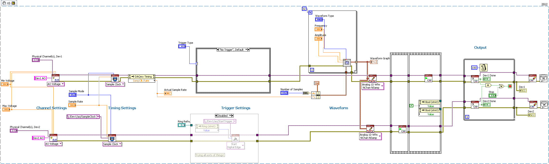

Here's the snippet
Message 5 of 9
(4,014 Views)
Assuming the "Enabled" case of your diagram disable structure just passes through the task handle and error wire, the software looks good (which is actually unfortunate, I was hoping it would be something obvious).  You're not getting any software errors, right (the screenshot seems to indicate that you are getting no errors)?

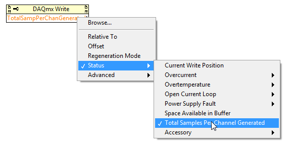

As a troubleshooting step, could you try polling the Total Samples per Channel Generated property for Dev 2 inside your loop?
If the samples generated number stays at 0, Dev2 isn't seeing the clock at all.

THE ANSWER IS ..........
                TotalSampPerChannelGenerated = 999                 (I asked for 1000.)
      Yikes!  What does that tell you?

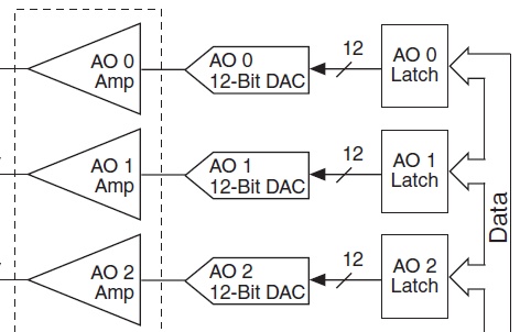

If you're consistently getting 999 samples then it's not a bandwidth issue (so ignore half of my previous post).
There's some bug or undocumented feature of the 6723 that's giving you this behavior.  The device is pretty old and I'm not too familiar with its inner workings, but I'll take a wild guess and speculate that your last sample is sitting in the latch and requires an additional sample clock edge to push it through (if this is true, it would mean that the synchronization was actually off by a whole sample clock period!):

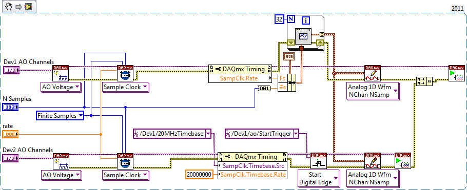

Instead of sharing a sample clock, I would configure your tasks like this:
This way each device will generate its own clock and do what it needs to output all of the samples.  The tasks will start synchronously due to the shared start trigger and will not drift over time due to the shared timebase.

Thank you SO MUCH, John_P1!
I implemented your suggestion (using shared timebase), and it worked!
Dev2 completed right away with 1000, not 999.  Should test with scope to make sure sine waves are lined up.
