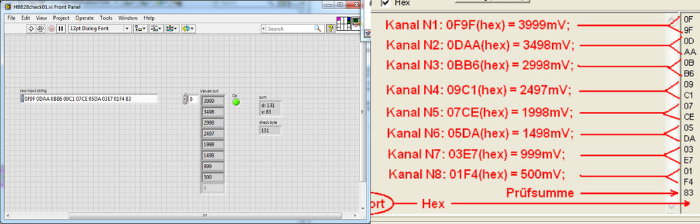

To GerdWs hint: Since you read 17 bytes the decimate to 2 arrays will drop the check sum byte.. (read Help of decimate 1D Array function) and leaves the 8 U16 values you need to scale to voltage.
I attached a check ... seems to work from the example shown.
Scaling to SI units is now your homework 😄
