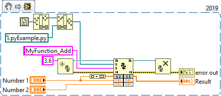

You can return a list of the same data type from Python as an array in LabVIEW. Does that satisfy your requirements?
Here's an example (modified from my previous example in another post):

cbutcher,
Yes thanks this is perfect! What's the easiest way to split the values of the 1D array back into the individual components of the array?
(11,893 Views)
In LabVIEW? Index Array 🙂
