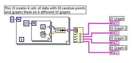

Assuming you're generating/acquiring data inside of the inner-most loop, you can enclose the loop inside of another for-loop which calls the inner code to generate multiple data sets.  Finally, index the output for your individual graph data sets.
Does this make sense?
-Bob

Yes.  Thanks.  I get the idea.
