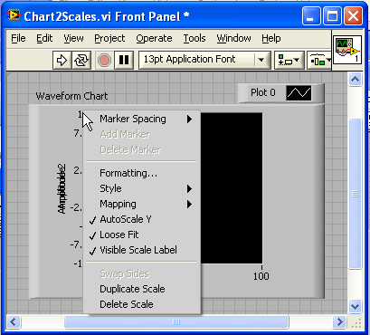

Again presenting an issue that I know must be easily solvable and indeed I have graphs with multiple scales in a number of my applications with the additional scale swapped to the other side. Today, in completing the following to create a second X- or Y-axis, 'swap sides' is always grayed out on the right-click shortcut menu.  I've clicked everywhere near the scale.  Using LabVIEW 8.5.  Any help is appreciated.

If you can, can you provide a screenshot that shows me exactly where you right-clicked to get an ungrayed 'swap sides' option to appear in the right-click menu on the attached graph?  I duplicated both the X and the Y scales.  By the way, I rebooted my computer just to make sure something odd was not happenning, but I am still having the same problem.

I just played around with my LV8.5:
On Waveform charts you (or: I) can only duplicate (and swap) the Y scale.
On Waveform graphs you (or: I) can duplicate and swap both scales.
(Right-clicking the scale numbers...)

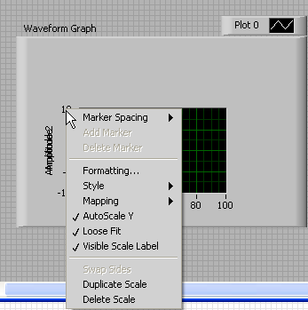

Right-clicking on scale numbers, 'Swap Sides' is still grayed. Does not matter which number or which scale.  It is still grayed. This is a waveform graph.  Anyone else have any thoughts on this?

Hi Don,
have you tried that with a new vi and a new Waveform graph?
Your pictures look a bit mangled as the duplicated scales are on top of the original one instead of next to each other. When this happens each time you create a new graph you should consider a fresh installation of LabVIEW Smiley Wink

Hello Gerd:
Yes, I opened a new blank VI and placed on the front panel a new waveform graph.  Yes, the new scales always appear directly on top of the old one, slightly offset.  And this no matter how I resize the plot area.  I don't know why.

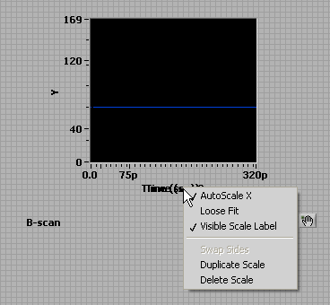

Hi Gerd - Unfortunately, same problem. Here is screenshot from your VI after I first deleted the second scale, then duplicated the Y-axis again...

Hi Don,
I don't meant to delete and recreate that scale.
Can you use my example as copy&paste source for your vis? This would be a way to postpone the fresh install of LV to some more days in the future Smiley Wink (Idea comes across: make a typedef from my control...)
