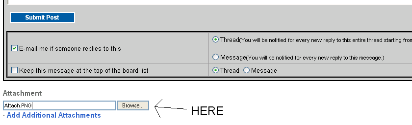

(BTW how do you attach images?  Help is no help.)

To attach a jpg image, first create the jpg file then start your LabVIEW Reply. Below the reply typing box is the Attachment box. Beside it, the Browse button lets you find the jpg file.

To attach images use the following
make sure you dont hit Preview Post though, because that will unattach everything.

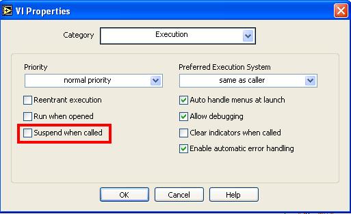

Can you attach your vi (for those people who have your version of labview) and possibly some screenshots? (for those of us (me) who dont have high versions of labview) Smiley Happy
As for why your program is pausing, is it possible you have the following option selected in File --> VI Properties?

Well, it is working now.  I didn't have the suspend when called box checked.  I replaced the problem subvi with a copy, removed some local variables, and closed and opened the file, and it works now.  I then replaced the copied subvi with an original and put back the local variables, and it still works.  I don't know why, but at least it works.  Thanks everyone for your help.
