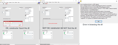

The issue comes when i call the parent class and make an instance of the child. In this case, even with the low level project open, the .NET constructor does not find the .NET dll and return an error. If I stop the VI and try to browse the dll manually, I get the error in the picture. The assembly mentioned in the error is in the same folder as all the other dlls.

I then added a direct call from TestStand to the "Connect.vi" skipping the classes, and it works since it calls the "Connect.vi" I had opened. But then in the step after I call the class that open another instance and of course it does not work. (picture attached of the double instance of the same vi)

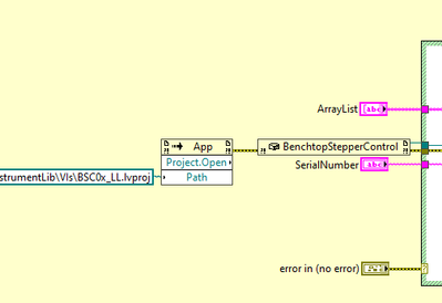

You’re both right, then I followed your recommendation to replace the GUI .NET constructor with one on the block diagram. Still pretty unstable and it work only is specific condition that I did not fully understand. But I found a configuration that systematically work loading the project in advance. Then to avoid the pre-loading I did it programmatically and it works.
It works in the following conditions:
  1. LabView environment. It works when I directly call the VI, it works also if I call it thru the instance of the class, and it works also in case of multiple instances (one for each different motion control).logatto_1-1709724736453.png
  2. TestStand. It works when I directly call the vi from the test sequence, no error from the constructor. BUT, the problem comes when I call it thru the class instance, for some reason I got an error which is the typical error that I get when the .NET dll is not pre-loaded. It seems that neither manually opening the project nor dynamically (as per picture above) opening make it works. I also added the path of the dll in the “Search Directories” of TestStand.logatto_2-1709724736462.png
