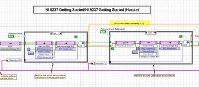

1. Does NI 9237 module really returns values in mV/V? I've found this info on the forum, but when I check examples, it seems, that it returns V/V. Where is the truth, please?

I've found also this link - https://www.hbm.com/en/3638/sensitivity/, which tells the same.
And seems, that NI 9237 returns V/V, although output range is -25 ... 25 mV/V.
