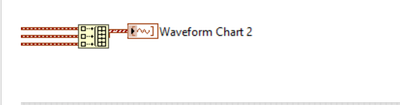

To show 3 waveforms in 1 chart , use the function Build array , and wire each waveform then plot on Waveform Chart.
These waveforms you need to write to the Analog Outputs according to the specs on your table.

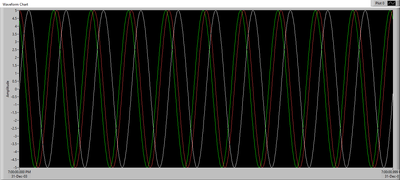

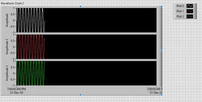

Thank you so much for your quick reply LVninja!
Is it possible to see the 3 phase in one chart/graph? The below chart still shows they are separately shown. The reason for this is because I want to show they are 120 degrees apart.
Message 3 of 58
(2,316 Views)
Yes it's possible, you just need to change how the data is presented.
Rick Click on the Waveform Chart and choose OVERLAY  plots - That's how the Waveform chart is setup by default when you first place on the front panel.
Message 4 of 58
(2,305 Views)

Yes, that's the same way to combine the 3 waveforms. Actually I believe when you place the waveform chart on front panel, they will show all waveforms overlayed mode by default.
Message 6 of 58
(2,277 Views)
Sorry I made a mistake, you need to select OVERLAY PLOTS to show all on the same.
