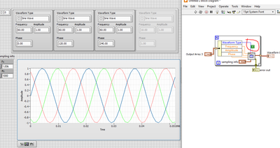

NI 9264 to produce 3 phase waveforms and shown in 1 chart
I tried using the sample Voltage Continuous Output and selected the channels 0, 3, and 6 to generate the same waveform but I encountered this error:
Please help.

The waveform settings array  - you need to add 2 additional elements in that array, one for each channel. I wonder if you can also setup the phase shift...

Hi LVninja,
I set the phase for these 3 channels as 0 degrees.
I want to create the next two 3 phase waveforms with 120 deg and 240 deg phases.
Do I need to copy paste the whole program for 0 deg 2X or can I create an array in the Physical channels and just increase my array in the waveform settings?

You can create the 3 phases shifted (u need to add the phase input on the cluster) but there is a Boolean input (RESET) that needs to be true , otherwise all phases will be 0.
As for the DaqMX task, are you setting up the 9 channels at once ? if so then the Array needs to have 9 elements. Sorry I don't have the device, that part u need to figure out by yourself.
I already increase waveform array to have 9 channels used:
Message 37 of 58

It looks like you created an array of 9 dimensions (🤷‍)
That should be 1 D array with 9 elements, one for each channel. Dont' forget to wire the Boolean TRUE on RESET.
