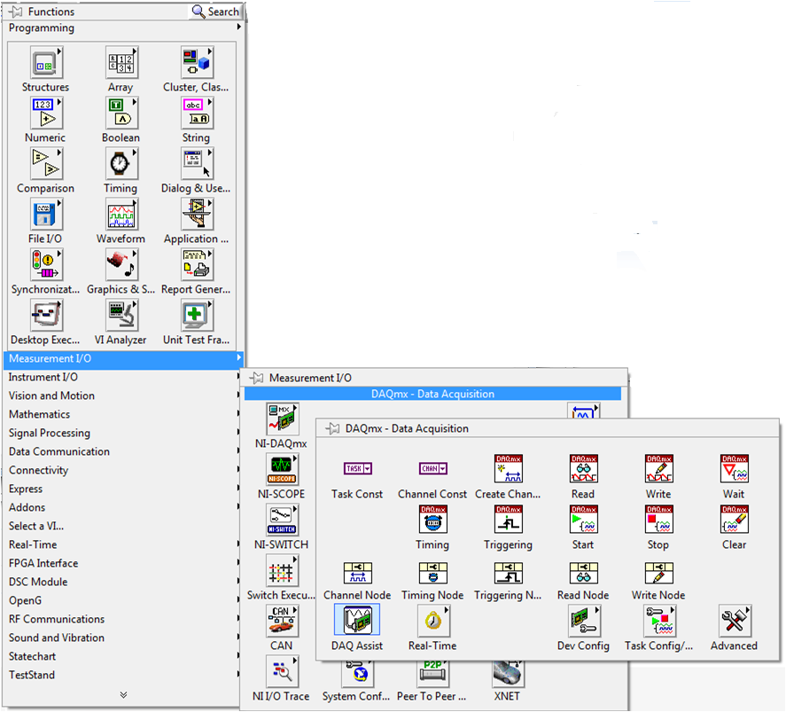

Hi there,
Can you check if you have DAQmx functions in Measurement I/O > NI-DAQmx in the function palette?
If no, did you re-install the DAQmx device driver together with LabVIEW 2012?
And what is your DAQmx version you're currently using?

I don't see the NI-DAQmx where yours is. What do you mean specifically when you ask - did you re-install the DAQmx device driver together with LabVIEW 2012? I believe it was installed with LV 2011 but not re-installed after LV 2012 was installed. The verson of NI-DAQmx is 9.8, thanks!
