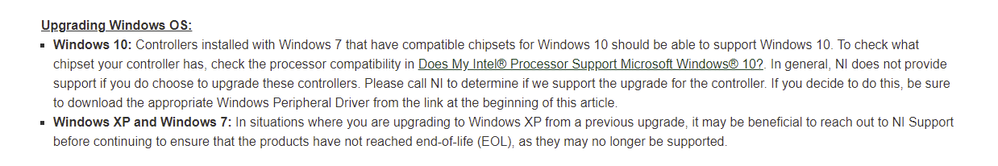

I have experienced Win10 lag significantly with 8GB or less RAM whereas Win7 is comfortable with 4GB.
https://knowledge.ni.com/KnowledgeArticleDetails?id=kA03q000000YHpFCAW&l=en-US
