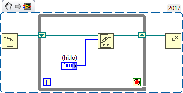

You should use open-save-close functions

@M.z779243 wrote: how can I log the data into file without slowing the read?
Also look into the Producer/Consumer architecture.  The idea is you have a second loop that does the logging.  The data is sent to this logging loop via a queue.  This way your serial port loop can just do its process and let other (parallel) threads process the data however they see fit.

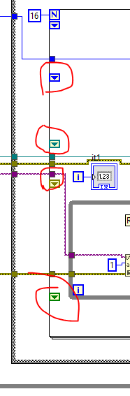

You should study the shift registers.
You lost file reference after pause
