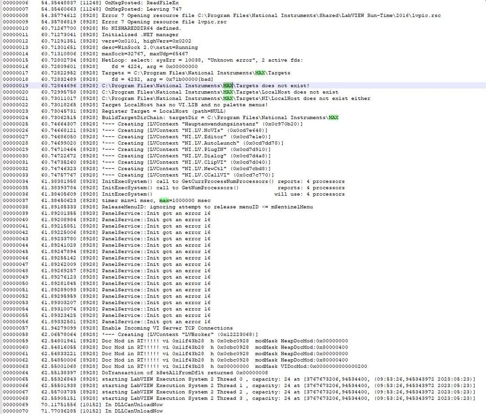

I want also to activate logs. In LabView you can add this line into Labview.ini
[LabVIEW]
debugging=True
Then it gives you debug / log outputs in DebugView
Perhaps it is also possible to add NIMax.ini in same directory as NIMax.exe and add "debugging=True".
Perhaps it will give logs then after restart...
I will give it a try...
BR
Eugen

It seems that I get logs !
Here the logs from one other machine, while starting NIMax (here NIMax starts and does not hang) :
