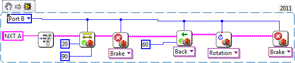

Hi Ailish,
You have correctly input the port name (Port B) to the NXT VIs but you haven't identified the NXT. Before the VIs you have already wired up you need to specify which NXT to use. I have a USB connection to my NXT and have tested your code with the addition of the "Specify NXT" VI. See below -

Hi Ailish,
I didn't take note of what the NXT was doing only that it worked! I just checked and no it didn't move back. See below a method to do this.
The second "Drive Distance" VI has negative 50 power directing the motor to reverse.
