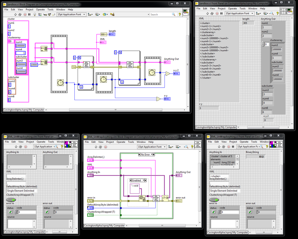

Image 1
In image 1 (above), there are 3 VIs: the sandbox for unit testing my XML wrapper and unwrapper, the XML unwrapper malleable VI, and the XML unwrapper core VI.  I'll go through what's happening here.
First the sandbox: So my test data is the cluster constant named "cluster".  My XML wrapper VI takes this cluster as input and outputs the XML text seen in the string indicator named "XML".  Then the XML unwrapper malleable VI takes this XML text and the original cluster as inputs, and tries to output a cluster of the same structure with all the values populated from the XML.

Image 1 also shows the results of executing the sandbox as so configured.  Looking at the sandbox front panel, we can see that the vale of the cluster indicator "Anything Out".  This is bad, it should be populated with the values from "XML".  There is a simple reason for this, which I will explain.
We can't see anything from the malleable VI, because it is reentrant, but we can see the control values of the core VI, because it isn't reentrant.  Here we see the cluster name is "Anything In", the name of the control in the wrapper VI.  However, the cluster element in the XML is named "cluster", after the original cluster.  Since there are no elements named "Anything In" in the XML, the core VI doesn't find any appropriate vales and outputs a binary string full of nulls.

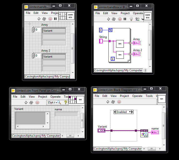

I decided to strip this problem down to the fewest possible parts where the behavior is still observed.  Attached are three pictures demonstrating the same behavior as before.
Picture 1 shows the "Get Type Information" VI getting the name of the VIM's control instead of the name of the string constant in sandbox.

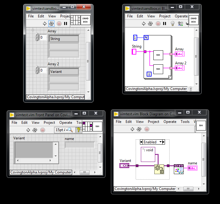

Picture 2 shows what happens if you "unwrap" the variant within the VIM.  One call returns the name of the string constant, the other call returns the name of the VIM's control.

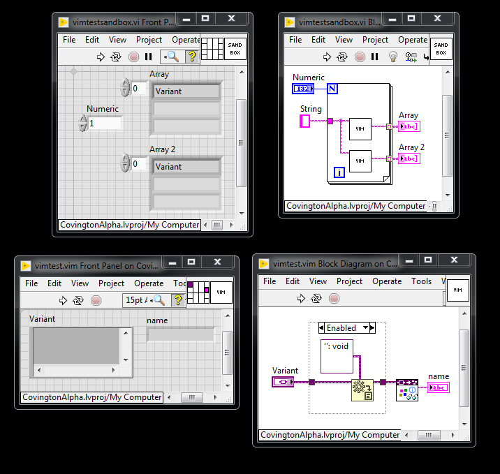

Picture 3 shows what happens if you increase the loop count from 1 to 2.  Now all 4 calls return the name of the VIM's control.
Here's a bonus.  If we replace the loop count constant with a control of value 1, both calls return the VIM's control name.
