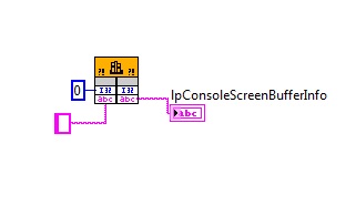

No that hasn't worked. When I create both the input and the output it creates an in and an out for each. Should there be just one input and one output?

I'm not sure but I think it's expected behaviour because the function just needs the refernece for the out parameter. Do you have some error right now or just the behaviour is different than expected?

The error code is 1517. Call Library Function Node

The vi is attached. i run a cmd window in the background and then run the vi hoping to get the data from the cmd window.

You cannot pass 0 to the handle because it doesn't mean anything. You have to know the handle to the console and I am not sure how to get the handle to the already open cmd window.
Can you maybe call the cmd window directly from LabVIEW? Then I suppose getting handle to it would be easy.
