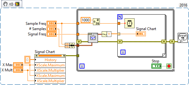

Sometimes the best way to learn how things work is to build a Test Case and do some Experiments.  As it turns out, there is a funny relationship between the Maximum and Multiplier properties, which you can experiment with using the following code I just cobbled together:
The Signal Chart is a Waveform Chart operating as a Scope Chart (mainly so you can see it "sweep").  The top three controls, Sample Freq, # Samples, and Signal Freq control a Triangle Wave Generator -- the default settings of 10, 100, and 100 means that it generates a 10 Hz Triangle Wave sampled at 100 Hz (so 10 points per cycle) and generates 100 points at a time.  The Wave part is fed into a timing loop to generate points every 1000/(Sample Freq) milliseconds (i.e. at a frequency of Sample Freq) and feed it to the Signal Chart.
The other two controls influence the X axis.  When the Chart is initialized (by having its History set to an empty Array), X Minimum is 0 (the default value) and we set X Maximum to the value at the right edge of the plot (default 100).  X Multiplier (default 1) determines how many "plot points" each X input takes on the Chart.  Ignore for now that I set both of these twice (we'll come back to this!).
If you run this with these default settings, it will "paint" 10 Triangle Waves across the screen, starting from 0 to 100, then 100 to 200, then 200 to 300, etc.  Here, the X Axis is clearly "generated points".  Try setting X Max to 50, then try setting it to 200.  What do you predict would happen?  Did it?
But suppose you want the X axis to be Time, not Points.  The default settings generate 10 waves every second, and plot 10 waves, so the plot updates every second.  Thus to show Time, X Max should be 1 (so Time goes from 0 to 1, 1 to 2, etc.).  But now X Mult, the amount of "plot" each X point takes, is only 1/100 of the plot, so X Mult should be 0.01.  So set X Max to 1, X Mult to 0.01, and before you run the test, make a prediction of (a) how the Waveform plotted differs from the X Max = 100, X Mult = 1 case, and (b) how the X "labels" will differ.  Were you correct?
So why did I set the Maximum and Multiplier twice?  Good question, best answered by doing more experiments.  Change the Block Diagram by deleting those two duplicate settings and see how the Plot changes.  You'll have to make a change, then "unmake" the change to "get a surprise".  Why does this happen?  It's a bit of a Chicken-and-Egg problem -- the two parameters are not really independent, but interact in a funny way.  It is also the case that when setting Properties, the order of the Property Nodes can matter (and does, in this case).
Anyway, explore, and teach yourself how to do this to solve your own problem.  I'll also attach this VI so you don't have to recreate it from the Snippet (in case Snippets aren't working ...).

Thank you for the detailed suggestion Bob! I have played around with some of the suggestions - perhaps you can tell me if I am seeing things correctly.
- pretty straightforward and what I expected; waveform chart plotted 50 samples and 200 samples respectively.
- I predicted X axis remained unchanged and this is what I found
- I thought this because changing the x axis to 0-1 in range, requires changing the multiplier to 0.01 and adapt the waveform chart to still display 100 points per second (each second displaying 100 data points).
- To me the multiplier almost represents an increment between each data point; if I wanted to display 1s of data I would just take the product of the multiplier and sample rate
- I tried settings of 1000 Hz sampling rate, X max of 1000 or 1, and multiplier of 1 or 0.001 - behaviour of waveform chart was what I expected
- If I tried settings of 2048 Hz sampling rate, X max of 2048 or 1, and multiplier of 1 or 0.000488 - behaviour of waveform chart was NOT what I expected. Is this related to chart history length of 1024? I would have suspected the waveform chart to display what I was hoping for which was a second worth of data (2048 points).
- Behaviour here was interesting. With settings of 100 Hz for sampling rate, X max of 100, and multiplier of 1, the change initially caused the plot to display 2 points instead of 100. If changed the code back and I ran it again, it would revert back to displaying 100 points instead of 2. Interestingly, if I left the code without duplicating the settings and ran it again, it would also revert back to 100 points instead of 2. This isn't what you were hoping I would see is it?

Regarding trying to plot more points than the History can hold, I haven't "done the Experiment", but suspect you are right (like trying to put 10 pounds of manure in a 5 pound bag).  As for changing Maximum and Multiplier only once, I haven't played enough to be able to say I have deduced the algorithm NI is using here, but there are definitely ways to make it "fail" and "recover", entirely depending on how the settings are ordered.  For safely, "Do it twice and don't worry about it" (particularly since changing the scale takes a tiny fraction of the time to actually produce and show the plot).
