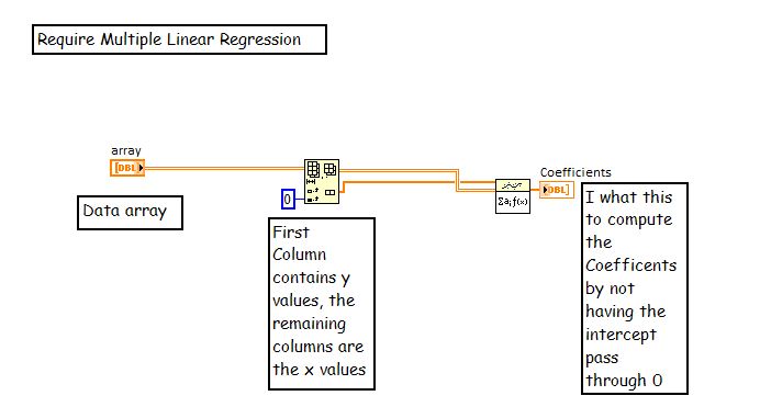

I think I have given everyone the wrong idea with my poor wording.  What I what to do in a muliple linear regression.  The image below shows an example of what I have so far.
I need to have the same Coefficent values that I get when using the Linest funtion in Excel.  The Linest function can be set to calculate b normally or set to zero.  I my case I have is set to calculate normally.  How can I do this in Labview?

Accepted by topic author Terry_S
Try appending an additional column to the data array that is all 1's.
Message 9 of 11
