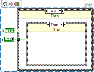

Sometimes part of our job is educating our Customers, Bosses and co-workers on LabVIEW
By definition, a If Then/Else structure in LabVIEW is a Boolean Case Structure.
If you where writing your code in C would you be able to
If X Then
    If Y Then
     Else
Else
     If Y Then
     Else
This is the EXACT equivalent in LabVIEW
You need to enlighten your customers.
As been pointed out above, without using case structure, all 100% of your code will run.
What if you were controlling a motor?
If X Then {run forward} Else {run reverse}.
Without a Case Structure, both the motor forward code and motor reverse code would run. What would the motor do?
Omar
Message 37 of 45
