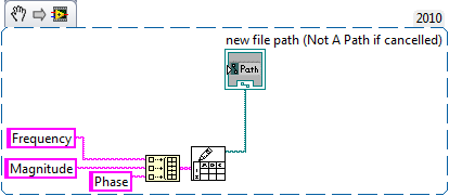

Do you know how I can add headers to each of those columns?
File Attached
Message 49 of 75
(3,387 Views)
You don't want to be using the write string to file VI, you will want to use the write to spreadsheet VI.  Attached is a snippet of what you want to do instead of the write string to file.
20451i455C7D287EBC8E74
