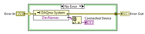

I have a NI USB-6225 DaqMx device which I have used a couple of years. When I started with LabVIEW I found the Daq Assistant the easiest way to measure voltage etc. with my Daq. Now my company has bought another NI USB-6225 DaqMx device and I have a big problem: The Daq Assistant in my old Vi's does not work with the new Daq. I understand why there is this problem, but I don't know how to solve it. I found this code on the forum that finds out which Daq is connected:
The problem is that Daq Assistant does not have an input for this, and it gives me an error if I try to run the code with a different device than the original I used when I created the code.
