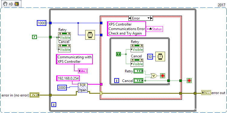

Try this snippet to verify that the Comms is working.  Don't forget to change the IP address to match your system.

Dear Ken,
Thanks for the vi. It is communicating with the motion controller but I am not able to move the stage with my code.

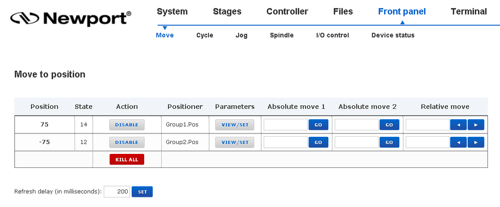

I don't think you need to login unless you enabled some security features. To configure your group and positioner names, go to the web interface. My "Front Panel" looks like this. I have groups: Group1, Group2 each with one positioner, which are named Group1.Pos and Group2.Pos respectively.

Error -18 is "Positioner name doesn't exist".  So you are connecting, it's just not able to move because the positioner name you gave it is wrong.
It's almost certainly the fact that you need to use "Group1.Pos" instead of "Group1" as the input.
The other error, -123, is due to the fact that only one connection can use the administration login at once.  As mentioned, for 99% of functions you don't need to be an administrator, so just get rid of the login VIs.
