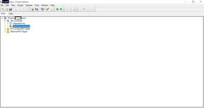

I got a project send to me after down versioning from 2017 to 2016 because the original project was in 2017, and I only have LabVIEW 2016. But after downloading the project and unzipping then opening the project, this is how it is. None of the files are present. I have all the files in the folder and I can open them individually, but they are not present in the project. Why is that? Please help me solve this. Thank you.

You need the Real-Time Module (and probably FPGA Module) to view files under RT and FPGA targets.

The distinction is between which files run on your local computer (everything under "My Computer") and which will run on the RT target ("RT Compact RIO target"), which is its own, independent machine. If you open a VI under an RT target and press run, it will execute on the RT target. You cannot do that without the RT module or the physical target.

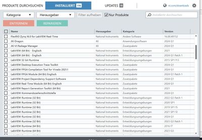

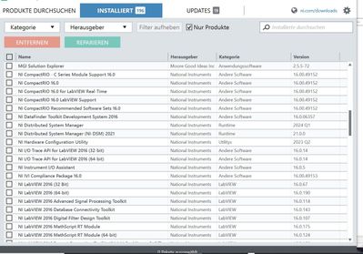

So I thought I can only access the VIs if I have an actual device connected. My mistake since I have never worked in real time targets before. But I found out I can access the VIs if download and install all the modules in my PC. If you look in the screenshots you will see all the RT targets I have installed. FPGA, compactRIO and Real Time. I have installed all and still I cannot access the VI. Why is that? Is it because of the version. The labview is 2016, FPGA and RT I installed are 2024. What is the problem. Thank you.
Message 9 of 20

Hi govindsankar,
did you install the support for the devices you want to use?
Each device (category) comes with a "support" package that is needed for Realtime targets…
Message 10 of 20
