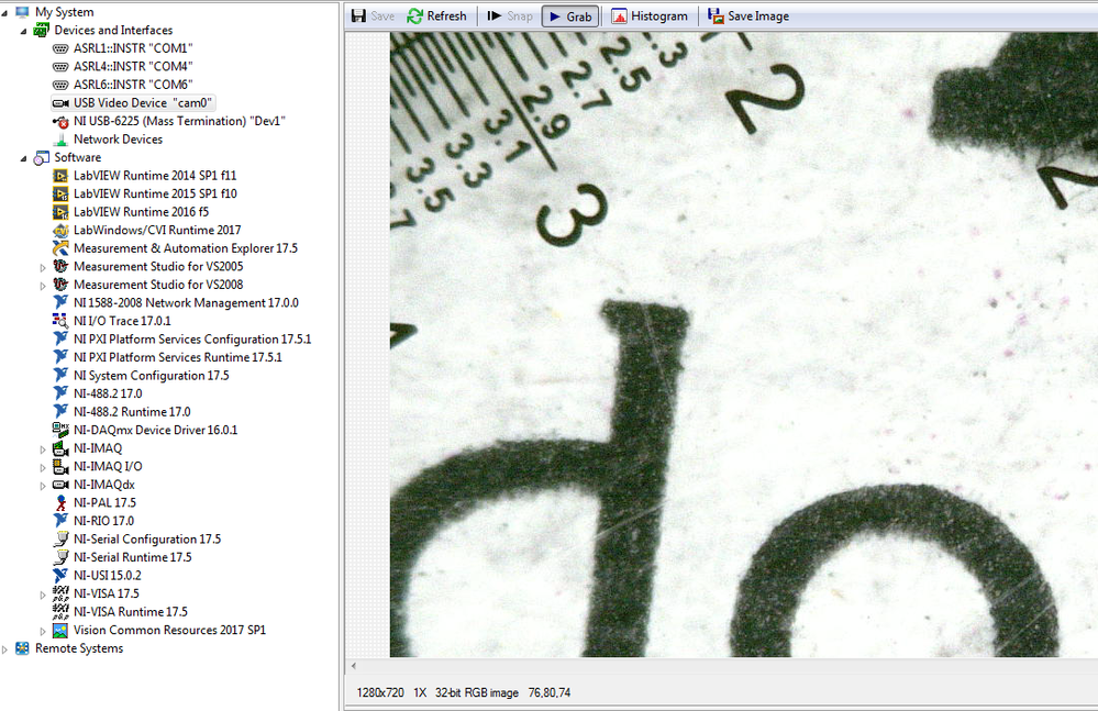

I have a stand alone LabVIEW application which displays the video feed from a USB camera. The application requires NI-IMAQdx Runtime video no longer displays following an update of the NI Vision Acquisition Software from 15.5 to 17.5 using the NI Update Service. The camera is still present and acquiring video and static images in MAX (shown below). But the LabVIEW application doesn't show the video.

Camera works in MAX.PNGThe

1. I repaired my NI IMAQ and IMAQdx programs (version 17.5) with my NI Vision Acquisition Software dvd as the source (version 15.1). I then ran MAX and my USB camera was not found.
2. I uninstalled my NI IMAQ and IMAQdx programs. I was also prompted to uninstall my standalone VI applications which required NI-IMAQdx Runtime. Then I reinstalled the programs from the NI Vision Acquisition Software dvd. This time MAX found my USB camera. I reinstalled one of my standalone VI applications which required NI-IMAQdx Runtime. Upon running it, a License Manager window popped up and I verified the activation code.
The camera still doesn't work. I have a new error code: -1074360311 (Camera not found).
This is beyond frustrating.
I go to MAX (which still sees the camera under Devices and Interfaces) to generate a Technical Support Report. I include my standalone VI application in the report. During the process, I get an error message: MAX doesn't associate the camera with any NI IMAQdx drivers. The icon for the camera under Devices and Interfaces changes to reflect the new status. I'm advised to right-click on the camera to change the settings. I do... and the camera is immediately discovered without me changing any settings. I generated two additional reports - one where I include the VI again, and one where I don't include the VI. I don't get the missing camera error in MAX again.
