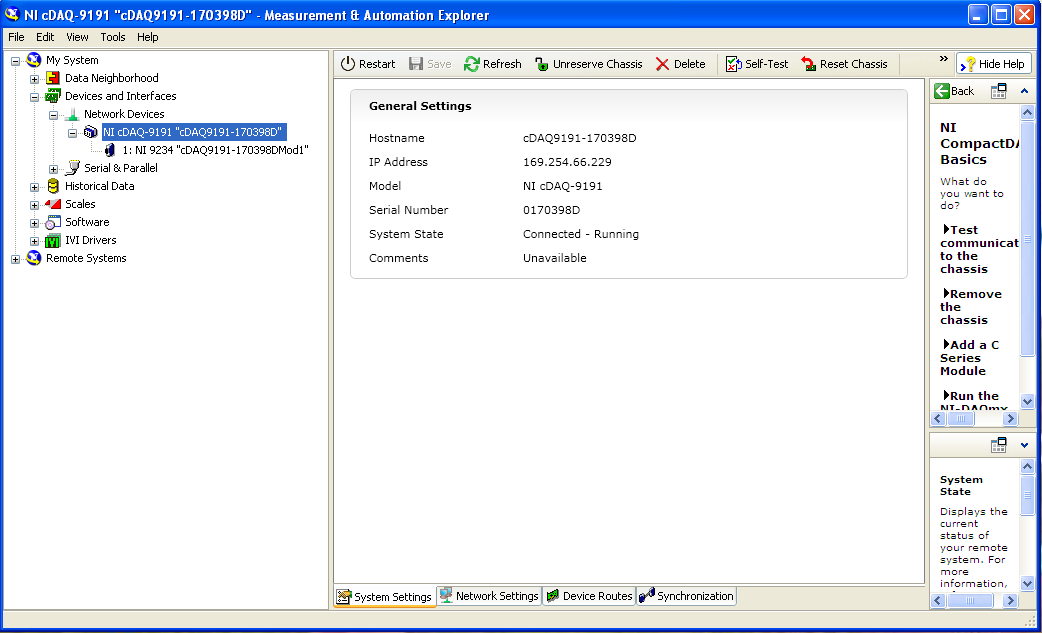

Thanks for giving quick reply.Yes I can see module in NI-MAX.In comments its not showing any comments.Is device is working , then why in network-settings "No Network adapter found " error coming.Even I cant update the firmware also.module.PNG

Which version of DAQmx are you running?
Please check if you have configured a "Proxy Server" in your network configuration. If so, you might give a try removing it (temporarily).

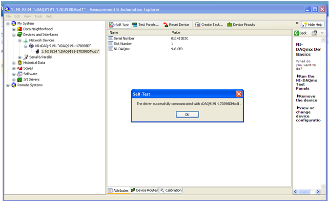

Hi sir,
Thnks for the response , yesI remove the proxy settings also.Still it showing the same thing in network settings.I downloaded both 9.6 and 9.4 DAQmx and in NI MAX its
showing ( NI-DAQmx 9.6.0f0) and on self test it show success.
