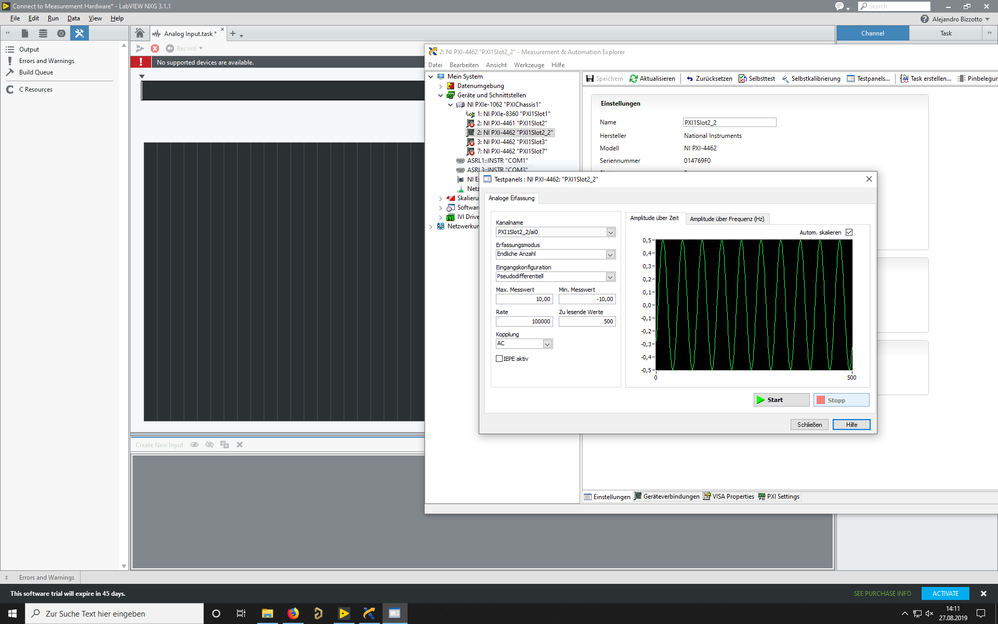

I'm trying to connect a PXIe-1062Q with one PXI-4461, one PXI-4462 and the interface card PXIe-8360 to Labview NXG 3.1.1 in evaluation mode.
If I connect the two boards, call MAX and plug a signal into the inputs I see the signal on any board, but if I open Labview I can only see the PXI-4461, the PXI-4462 never works, I tried by change the cards positions or even plug just the PXI-4462 but Labview always says 'No supported devices available'
Any ideas?

When I look here I see the PXI-4461 but I do not see the PXI-4462 listed as supported devices in LabVIEW NXG 3.1.
