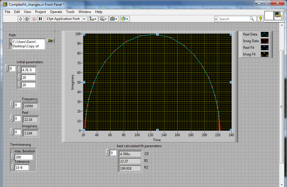

Works fine for me, only had to add some initial values to your VI.  By the way, you only display two plots, data and fit, both as imaginary versus real, so I also had to autoscale X to see it.  Anyway, no errors for me.

Here is the LV10 version with a few more simplifications (cut out the file reading and replaced with default values).  Replaced the VI path with a static reference.

That definitely works, thanks.
