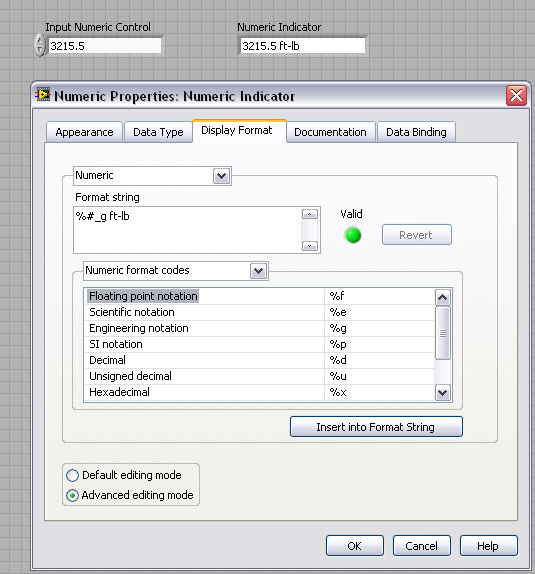

If you are mearly looking for a way to display your data with units, I have found the best looking and most space-effective way is to modify the appearance of the indicator and have the units show up right in the data.
Right Mouse click on the indicator and go to "Display Format..."
Click the "Advanced Editing Mode"
In the "format string" field where the number pattern is, just type a space and then your units. Hit ok
Check it out
Message Edited by rex1030 on 10-07-2009 10:00 AM
