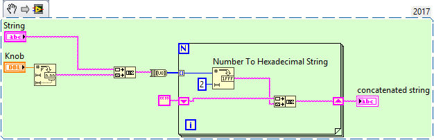

Not sure, but maybe this does the job (I removed the CRC part):

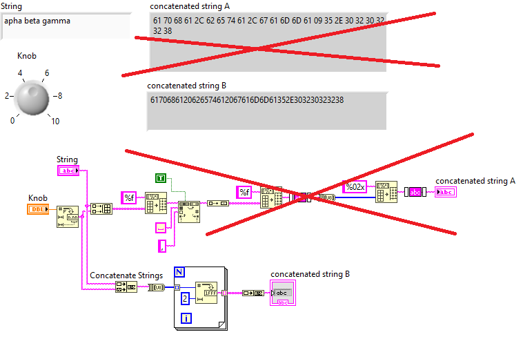

Here's what I would do (skipped the CRC for now)

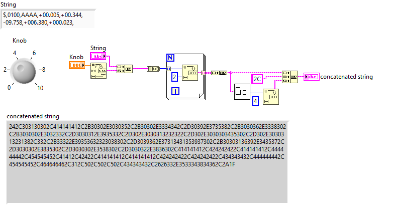

I do get a "24" for the $. I haven't inspected the CRC calculation, but maybe something along these lines would do what you want after some more tweaks.

and ir can you please help me with how it reverse will work
