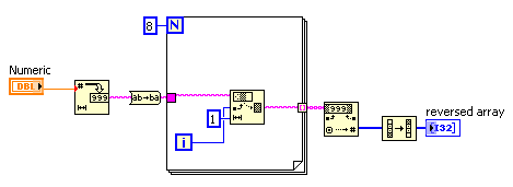

Below is another way to do it.  There is no checking to make sure the number is eight digits or less, so you may want to write that in, as well as any other error checking you think is necessary.
Cheers!
Message Edited by jmcbee on 04-22-2008 10:04 AM
(3,234 Views)

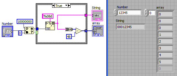

Can also do without loops
Message Edited by smercurio_fc on 04-22-2008 11:51 AM
(3,216 Views)
Exactly! 🙂
I would check the range of the input with the desired boundaries, else there is a chance that the output array is more than 8 digits.. Also, the 48 diagram constant should be U8 to avoid the measles. :o:D
You might want to adjust the upper limit to exactly what you need. Also (include or exclude it as needed)
Message Edited by altenbach on 04-22-2008 10:21 AM
(3,207 Views)
Hah! Quite right. Goes to show you what happens when you slap something together quickly! Although I wonder if my aging eyes might have something to do with it. Smiley Very Happy
(3,192 Views)
