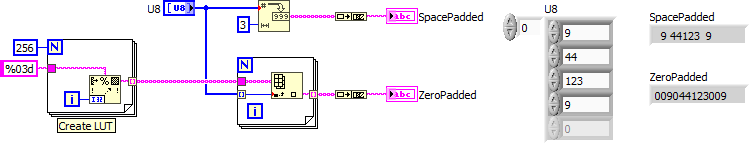

If you want space padded to 3 digits, just wire the array to the primitive and insert a "concatenate string" to the output. No loop needed.
If you want zero padded to 3 digits, I would recommend a LUT if the array is large. There are only 256 different strings.
