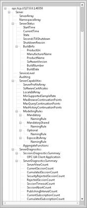

A while back I was messing around to see if I could create a simple OPC UA browser. As with many side projects I lost interest after getting some of the basic functionality working but I have some of the basic functionality up on GitHub if you wanted to take a look at that.
https://github.com/jacobson3/UA-Server-Browser
Right now you can point it at a server and it will build out a basic tree structure for you which will display the browse name but have the actual tag value tied to the unique node id.

Have been taking a look at your example and can use it to see all of the tags on my cRIO OPC UA server, very nice!
This is a good beginning to something that really should come with the OPC UA toolkit.  I would like to see if I can extend your example to function like the Distributed System Manager which is a great tool for browsing NSV's.
