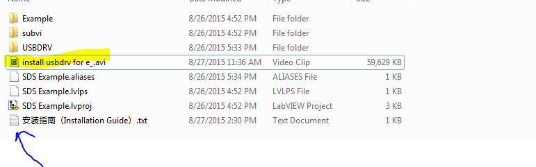

I  just have to ask
did you see this attachment in the download?  Did you watch it?  did you do it?
That Installation guide you didn't read either tells you to watch the video
Message 5 of 9
(6,808 Views)
Sorry for wasting everyone's time. After following the instructions in the video, my oscilloscope works -.-. The video is in Chinese and made on windows xp so i followed a separate installation guide from the manufacturer (there wasn't one in my downloaded folder like you have). Apparently the separate installation guide only gets you so far. Again, I should have caught this myself but thank you all for your time, it is much appreciated.
