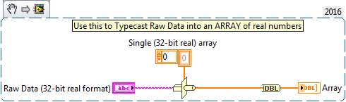

This is what the typecast should look like. I don't have a PNA in front of me, but it works on every other Agilent/HP/Keysight analyzer that I have.

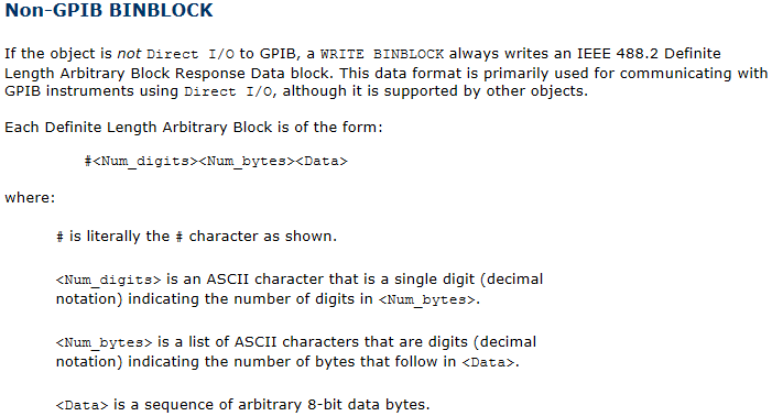

I noticed in your SENSE.vi,you set the byte count to 1024 in the VISA read . Don't!! If you do use REAL32 format, it comes back as IEEE Block Data (see below for BinBlock format). You can't just read 1024 bytes. The actual amount of bytes to read is embedded in the header. Use that as the input to the VISA read byte count.
Another gotcha, temporarily turn off the VISA Termination character. By random luck, some of the raw data may be the term char (\n) and the VISA read would prematurely end before all the raw data is read. Turn the term character back ON after the block transfer.
Message 9 of 29
(6,493 Views)
Oops, forgot one more gotcha.
Agilent terminates the BinBlock with an extra new_line (\n). So the actual amout of <Data> is <Num_Bytes> + 1 (Not sure if this is per the IEEE or not).
If you don't read that last byte, the next VISA read operation will get the that new-line as the first character, assume it is the Termination Character, and you get and empty string back.
