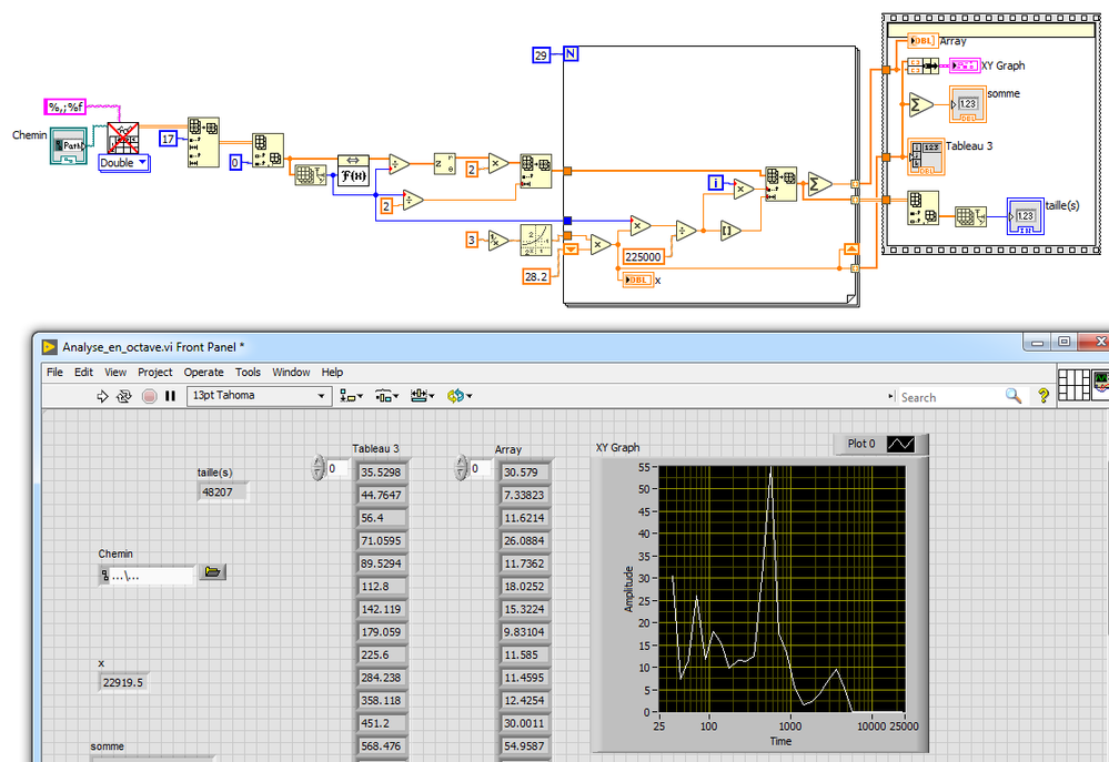

I would like to implement my own octave analysis withou using the sound & vibration tool kit ( i dont have this kit )
so what i did in this program is calculating the FFT of a time signal then i calcul a 3rd band octave, so i split my array into 29 band and each band represent a 3rd band octave then i will make a sum of each subarray ( 3rd octave) and display in a graph.
But i have an error that display when i run the code i hope that you could help me in implementing this analysis
I have a 225 KHz as a sampling frequency signal (i recognize that the length of the signal is much longer).
Thank you

Hi virtman,
Which error do you encounter?

Hi GerdW
Actually it display me this error
But also i would like that my graph will be represented as a bargraph how i could do that please !
Thank you
Message 7 of 25
(11,186 Views)
Accepted by topic author virtman
Hi virtman,
I had the same problem - and solved it by placing the sequence frame around the output terminals…
(I guess that's a compiler artifact. Sometimes the compiler has issues in handling all data correctly. A quick help is to throw some AlwaysCopy nodes on your wires or to enforce some other kind of data copies…)

Hi GerdW,
Thank you so much the first problem is solved wich is great !
for your 2nd proposition i changed the properties as you have said but i am not sure wich property i need to choose because it seems like my graph is pushed from a side to an other when i change the properties !
My last question is about the amplitude axes and frequency if the time signal amplitude represent a physical unit, i would like to know if my octave analysis is displaying the correct values that corresponds to that unit ( should i just need to make the sum of the frequencies in my FFT or what i did right now is the true way to implement an octave analysis by making the sum of all what exist in my subsarray please!)
thank you so much and it is so helpfull from you

Hi virtman,
As you didn't attach your VI I don't know what you did…
You should know that on your own…
What is the expected result of your calculation? Use a reference data set and compare your calculation results with know reference results!
(I'm not an expert in octave analysis, and will not dig any deeper into this algorithm.)
