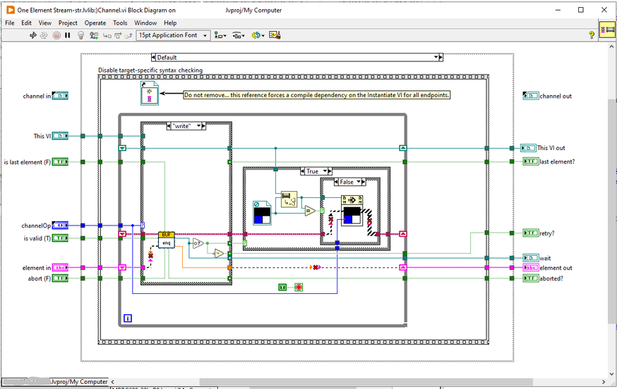

Hi, I updated LabVIEW 2022 Q3 over the past couple of months, and the One Element Stream-str library's Channel.vi in 32-bit LabVIEW seems to now be broken from what was working in LabVIEW 2021.  I tried today to update to Q3 Patch 1, and it's still broken.  I'm running it on Windows 10.  Could someone look into this or provide a workaround?

I tried deleting the ChannelInstances folder, but now it's gone and I can't create a new VI with a One Element Channel.  I'm trying to rebuild it with LabVIEW package repair.
The VI I'm referencing is a subVI to Read Endpoint - NI .  The VI should be available in your LabVIEW 2022 Examples in \National Instruments\LabVIEW 2022\examples\Channels\Basics\
I think the issue is tied to a new Windows profile configuration on my computer that puts the Windows account profile on a server rather than the local machine.  Now, the same VI in my LabVIEW 2021 folder is broken too.  Does LabVIEW 2022 recreate this  "\LabVIEW Data\<version>\ExtraVILib\ChannelInstances" folder every time the "My Documents" folder is accessed, or is it created during the LabVIEW 2022 install?
