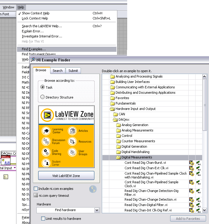

A good place to start will be checking out the examples in LabVIEW. You can get to them by navigating in LabVIEW to the Help menu » Find Examples. This will bring up the Example Finder. A few good examples to look at for your application will be the digital measurement examples. They can be found when browsing by task under Hardware Input and Output » DAQmx » Digital Measurements.
Here is an example I modified which will stop a loop when the value changes from a high state to a low state.
I hope this helps!
