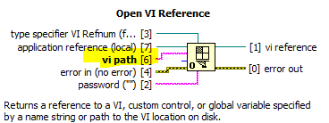

my code calls some subVIs by reference by using "Open VI Reference" and "Call by Reference" VIs. Now, "Open VI Reference" expects a path to the VI:
When the SubVIs sit in the same folder as the calling VI, it is easy to simply supply the name of the SubVI. However, I would like to call a SubVI that is part of a project library sitting somewhere else on the disk. I could give the relative path, but this make the code pretty inflexible and if the relative path changes all the paths would need to be ammended. Ideally, I want to utilize the fact that I am using a project library. The help for Open VI Reference states that
vi path accepts a string containing the name of the VI that you want to reference or a path to the VI that you want to reference. If you wire a name string, the string must match the full delimited name of a VI in memory on that target. If you wire a path, LabVIEW searches for a VI in memory that you previously loaded from that path on the same target.
 I thought that the underlined path was my ticket and tried something like this:
