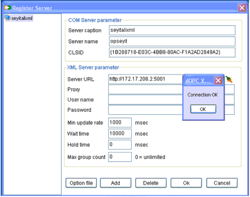

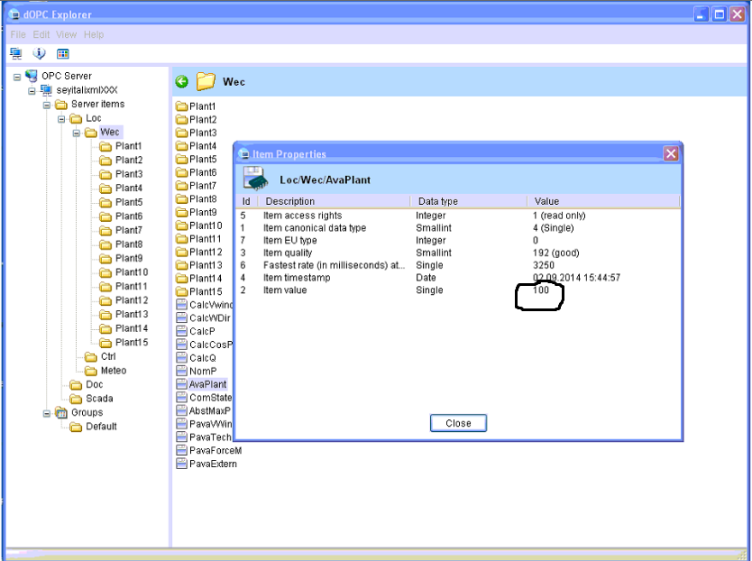

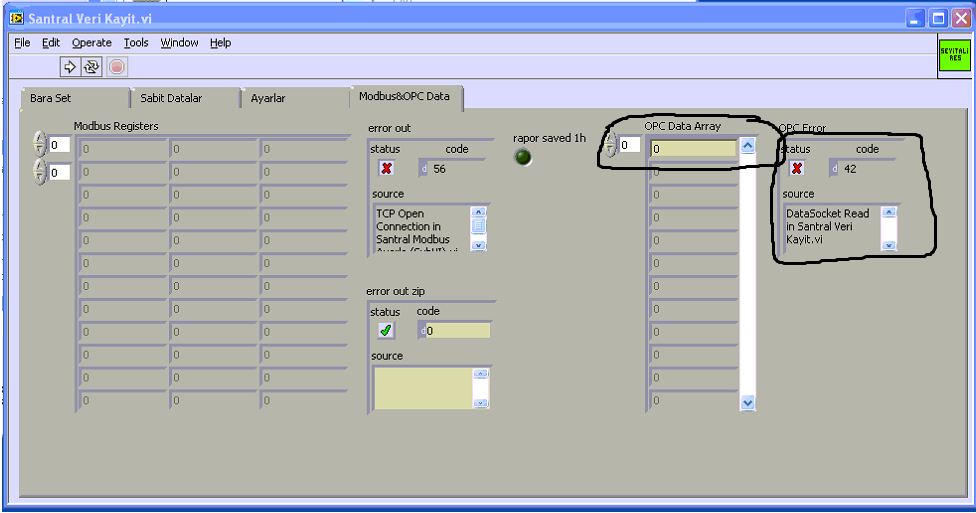

I have a problem about DataSocket Read Function . I want to read some data from OPC server. I read data and its value 100  as seen in picture dOPCexplorer . But when I give a start Labview .exe as seen Santral Veri Kayıt.vi, I get error 42 about DataSocket Read. Can anyone help me when solving this problem?
