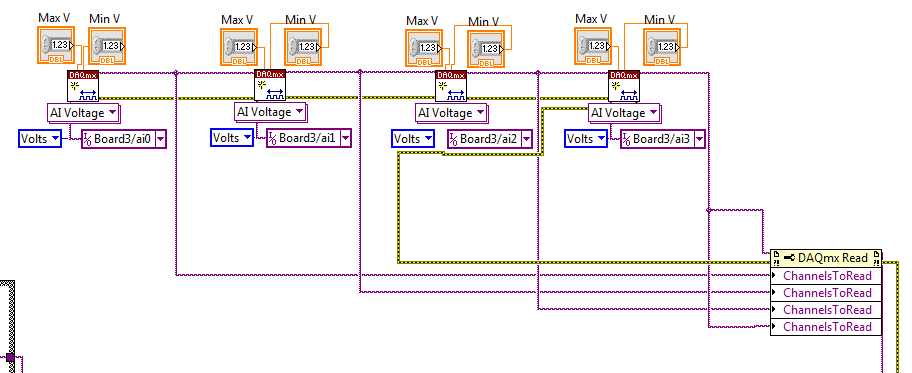

Hi Daniel,
thanks for your reply and help.  I have wired up what I think you mean (see image below).  I am assuming that the order of the "ChannelsToRead" listed top-to-bottom in the DAQmx Read Property Node is the order in which they will be added to the array (first the top; last the bottom).  Is this what you had in mind?

Somewhat. The 'Channels To Read' property actually accepts a DAQmx Global Channel data type, while you have a DAQmx Task Name data type. So the correct way to utilize the DAQmx Read property node is to just creat a constant or control from the 'ChannelsToRead' property and entering in the order of the channels you would like. I have provide a VI snippet to help illustrate:
