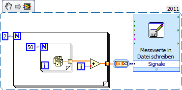

Hi ghp,
using this sample code I create a LVM file with two data columns:
