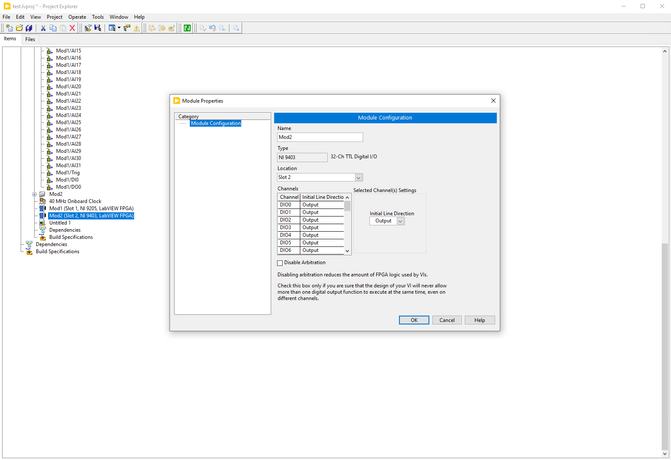

I am quite new at LABVIEW environment, I have NI9403 Module which has 32 digital I/O s and implementing a LABVIEW FPGA project. I want to use these digital output pins as outputs and configured as "output" as follows:

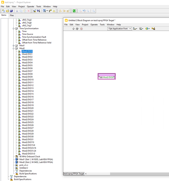

However, still when I try to add these pins into the block diagram, it is recognized as "inputs" like:
So, am I missing some point, thank you very much in advance for anyone who can help.

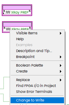

I think it should be possible to change it to write as simple as
You can also read (and write, of course) output pin without any problem.
