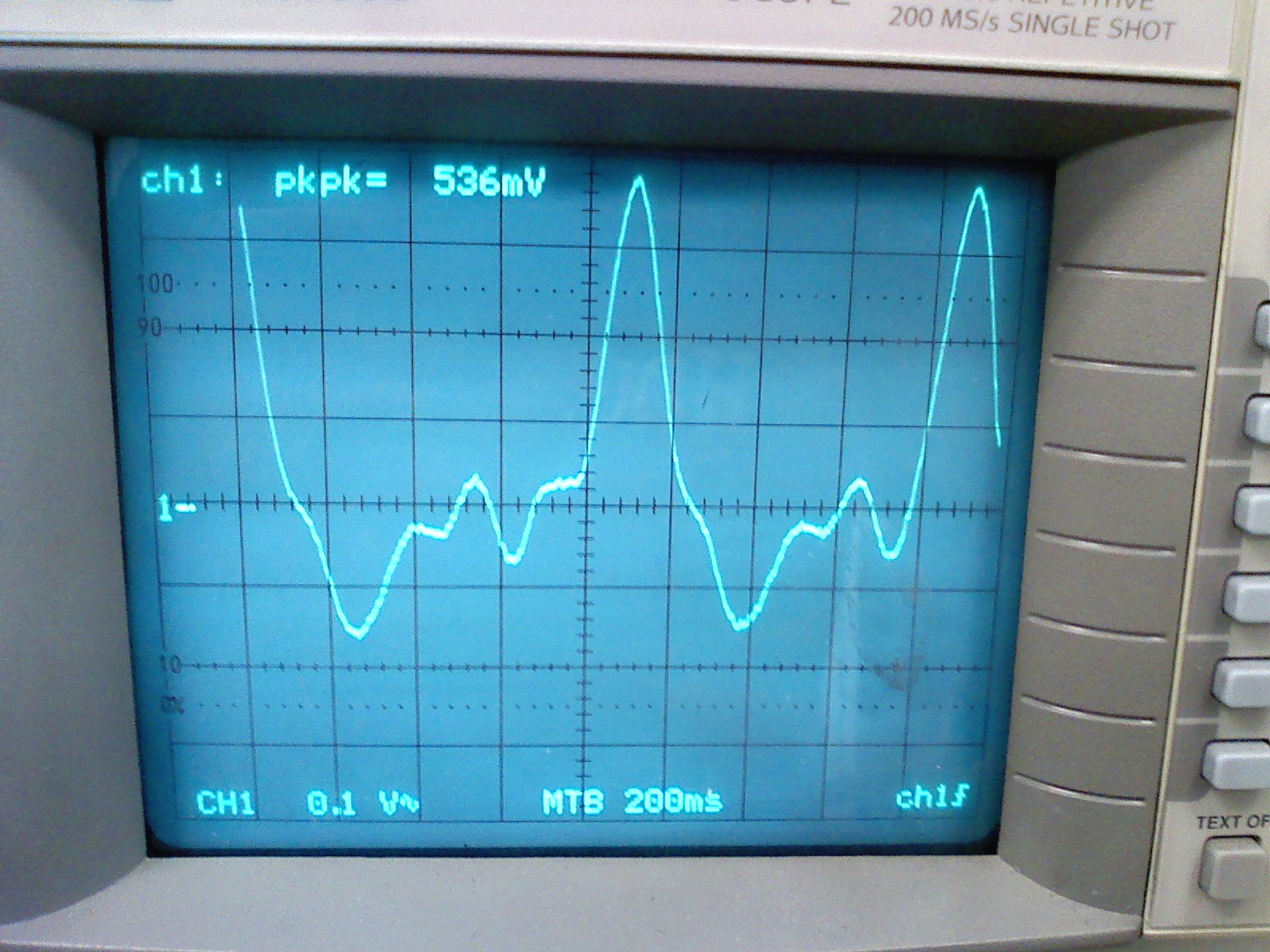

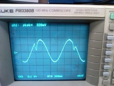

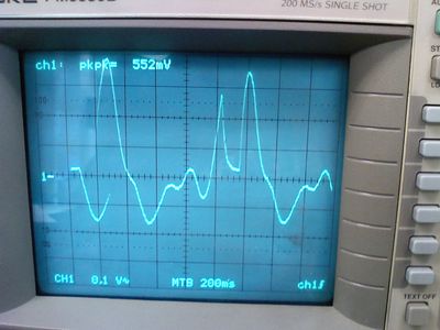

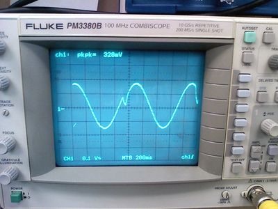

The first picture is of the waveform during a cycle without the artifact.  The second picture is the waveform with the artifact cutting the peak in half.  The third and forth picture are the same program with a simple one term cosine fuction, but the blip is still
visible.  Any help would be great.
