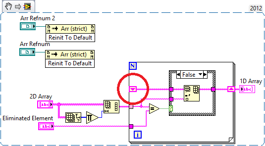

I'm not sure what a problem is and how to name it so please excuse my confusing subject. Basically, I had a subVI which converts a 2D string array into a 1D string array and also eliminate unwanted elements in the 1D array. So I called that subvi in another vi where the input is a 2D string array which has different column sizes:
a b c
d e
so LV automatically fills in the blank with either empty string or "0" if the array is a double array.
Since I have two different arrays, I want the subvi to be executed simultaneously, but every time I run this vi, the array outputs from my convert2Dto1Darray keep appending on the results from the previous run rather than update the output arrays even though in that subvi I created an invoke node for both input and output arrays to programmatically reinitialize the arrays to their default values which are an empty array.
It did some research on simultaneous run on subvi and has set shared clone reentrant execution on the subvi, but it didn't fix the problem.
Any help would be greatly appreciated!
MV

The shift register is uninitialized, so it keeps data from previous runs. Feed an empty array in to initialize it.
(3,662 Views)
Fixed! Thank you so much Gregoryj!!
(3,651 Views)
Please attach the actual VI instead of pictures and snippets. Your entire code seems extremely convoluted With way too much duplicate and inefficient code, but yest, the uninitialized shift register is the main cause of your observed problem.
LabVIEW does NOT support "ragged" arrays, so all rows (or columns res.) of a 2D array are the same length.

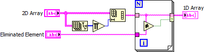

  • We are still missing some subVIs.
  • As I said, eliminate duplicate code. For example, the two FOR loop stack on the left could be combined into one stack.
  • Unless the files are gigantic, it would be sufficient to read each exactly once and then pairwise operate on the data instead. You are currently reading most files multiple times for no reason.
  • Your subVI could be dramatically simplified using a conditional tunnel.eliminate.png
(3,572 Views)
