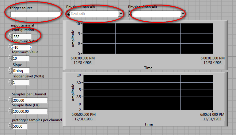

Hi detech,
The connection diagram would be also helpful, as well as a screenshot of how your front panel is configured.  It would be helpful to know the following information:
Also, it woudln't hurt to post the screenshot after you've ran the test so we can take a look at the actual signal.

Trigger source: APFI;
Chan : DEV1/AI8;
Chan: DEV1/AI0;
Input config: RSE (which is only one working wright)

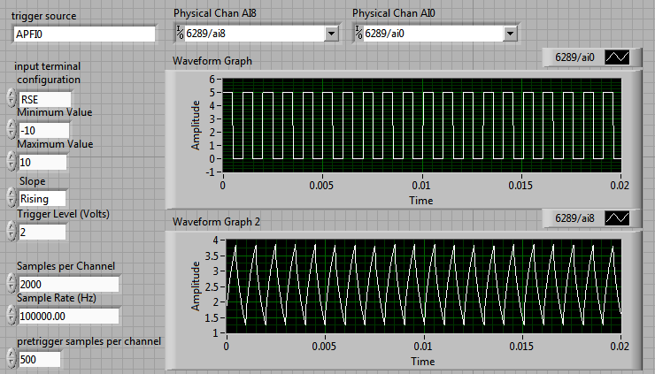

The code works fine on my system (using APFI0).   This is the result I get:
The AI8 channel I just left unconnected--the sawtooth present is a result of ghosting.

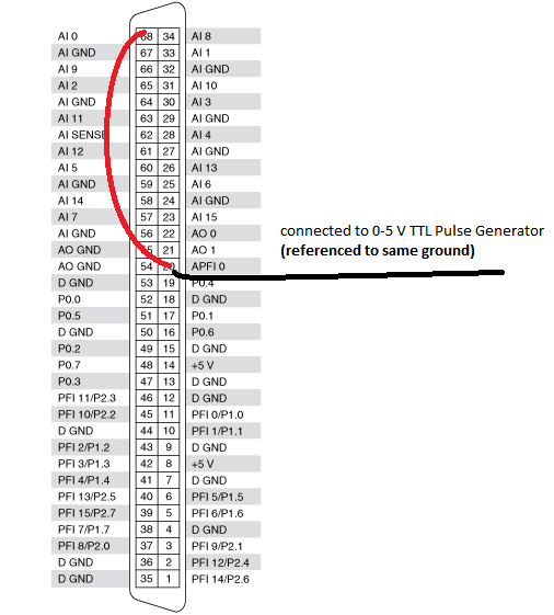

This is how I have it connected:
Could you please provide the same information (screenshots of both the measured signal as well as how you have your signal connected).  I'd like to offer some advice but I don't really have any information to work with at this point.

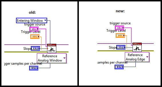

I should add that I did make one change--you had configured an Analog Window Trigger when it sounds like you wanted an Analog Edge Trigger.
Now that I think about it, this might explain the behavior you were seeing.  It was a bit confusing since the labels on your controls corresponded with those that would match up to an Analog Edge trigger.
Anyway, try changing the polymorphic trigger VI as follows:
