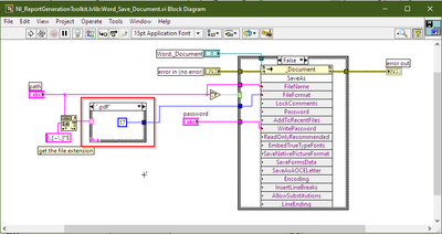

Hi alljustforfun11,
There is a simpler method to create a pdf file from a word document in LabVIEW that they failed to post in "https://forums.ni.com/t5/Example-Programs/Save-Word-or-Excel-report-as-a-PDF-using-Report-Generation...
Give direct pdf prefix path to the vi  "C:\Program Files (x86)\National Instruments\LabVIEW 2015\vi.lib\Utility\NIReport.llb\Word\Save Report to File.vi"
It is handled to save the pdf as shown below
Muthu Karthik.M
(4,399 Views)
Why is that simpler?
In stead of a method with clear inputs, you get a method with variants that need magic numbers to be wired.
It's good to have alternatives of course...
