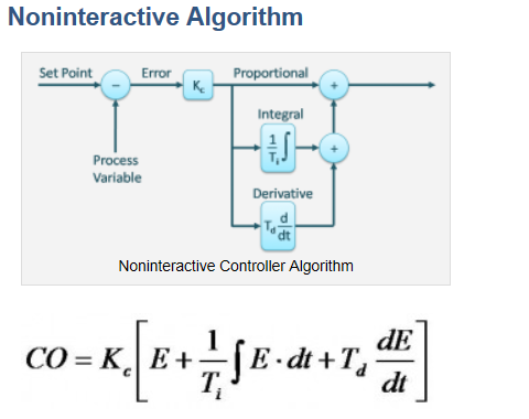

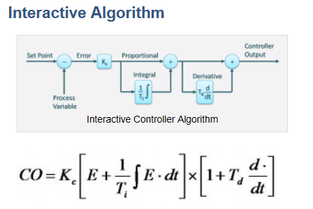

AndyClegg,
Thank you for your timely help. But, (maybe I misunderstand your mean), setting Kp = 0 and Ti = non-zero value may only exclude parallel algorithm, still the interactive and noninteractive ones behave the same. Can you please clarify a little further to me?
The following pictures are grasped fromhttp://blog.opticontrols.com/archives/124. .
Su

It is rare to see that structure you have labelled the "Interactive Algorithm" used in practice - so normally you are just trying to distinguish between ideal/parallel. Different people/companies use different names for the structures, so I always to use the block diagram or equation to distinguish.
Looking at the help on the RT PID block it doesn't say which it is - so somebody from NI who can see more detail has to really reply - though the block icon seems to imply that it is parallel. In fact there are a number of nice looking useful features on that block that really need a bit more explanation about what they do - for example the beta term - before somebody can deploy them confident in how the block will work.
What I suggest below will show if it is parallel or not. The difference between the other two is clearly only important if you are using derivative. It would be usual for it to be the one called "Interactive" but if you do need to distinguish by testing then you could either:
1. Do a frequency response test on block - and look at bode plot and compare that to bode plot of each of the equations in Laplace form.
2. Look at output from block on a sample by sample basis - and compare that to sample by sample output from ecah of the equations but put into discrete time form.
I too am now curious to know this, hopefully one of NI control people will be able to give a definitive answer.

Just to clarify the terms used for each structure:
  • what I call the "Ideal" (and is shown above labelled as "Non-interactive"), NI refer to as the "Academic" structure. I do find this naming a bit strange, as this is certainly the one which is more widespread in applied control - as it is simpler to tune by manual tweaking. And when I got taught about PID it was the parallel form. Oh well.
  • what I and NI call "Series", is shown above labelled as "Interactive"
  • we all call the parallel one, "Parallel"
If you work with industrial controllers, using their pre-built PID blocks, you will find different manufacturers call their PID structures different names, so I always check the equations or block diagrams to distinguish.
