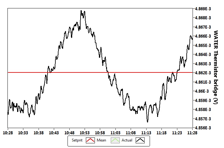

I have a circulated water loop, and I control its temperature in the following way:
The sensor is a thermistor bridge, this bridge is driven with a 5V precision reference (http://www.voltagestandard.com/New_Products.html). The output of this bridge is connected to a Keithley 2182 nanovoltmeter. My LabView PID control (i have PID toolkit purchased) drives a Keithley 2400 current source which is connected to a solid state Peltier water-to-air heat exchanger. The air side of this heat exchanger is in a temperature controlled cabinet (air temperature stability is +-0.02 Celsius). The thermistor bridge gives a signal about 50 mV/Kelvin at the 5V excitation.
I have attached a picture, where you can see one hour measurement data (1 Hz sampling rate). Typically I have a stability +- 3E-6 Volts (standard deviation), which corresponds to +- 6E-5 Kelvin stability.

Overall, I am satisfied with my temperature control, but I am looking for advice how to remove the visible oscillatory effect. This oscillation has a period time about 30-40 minutes, as you can see in the picture.
Is there something I could try to make my control even more precise? (it is also possible that I am already at the possible barrier given by the structural confines...)

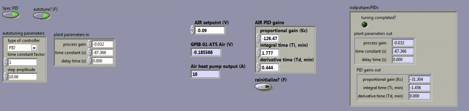

My first experiance with the PID Autotuning (Temperature) VI:
I started to use this VI on my cabinet air temperature control unit, but I have realized some strange thing:
When I use the autotune function, I have to specify the autotuning parameters. In the manual, the step amplitude is defined like this:
"step amplitude specifies the amplitude of the setpoint relay action. The setpoint relay is between setpoint - amplitude and setpoint + amplitude."
But when I start the autotune process, what I see is this "step amplitude" is not the relay action for the setpoint, but the VI use this value as a constant (?) output...is this a bug?
Message 6 of 39
(19,505 Views)
very bad: during autotuning, the VI just sets the output to be equal with the step amplitude, and also, even if I specified to tune the system to be PID control, the D parameter is always zero...
What do I do wrong?
(in the pic you can see the initial pid values, what I have got via the manual Ziegler-Nichols method...)pid-airloop.png

Can you plot the output from the control loop (the value being written to the current source)? More specifically, plot the output from the Keithley (if available) since the PID algorithm may output values with a finer resolution than the Keithley can generate; otherwise, round the PID output to match the resolution of the Keithley. See if the current alternates steadily between two specific output values, or if the output is changing continuously over the course of the oscillation.
What I suspect is happening is that you've reached the limit of the resolution of the current source, in which case it will be difficult to eliminate this oscillation using PID because the current source cannot output the exact value that would allow you to maintain the desired steady-state temperature. If this is the case, the output will cycle between the two closest output values and you'll always have some oscillation. You could try increasing the integral gain (reducing the integral time) to see if you can get a faster response and reduce the amplitude of the oscillation, but the tradeoff may be greater overshoot when you change the setpoint.

Very good idea!
Usually the water-to-air heat exchanger requires a current around 130 mAmpere from the Keithley 2400 to maintain the setpoint temperature, and remove the excess heat from the inner loops of the calorimeter.
Therefore, the Keithley 2400 sourcemeter is used in the +-1 Ampere range, what has the worst resolution.
Thanks for pointing out!
