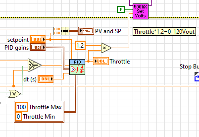

I did something similar using a California Instruments programmable AC source and a strip heater.
The output of the PID VI's is a number between 0 and 100 (%Throttle)
I was using a 120 volt strip heater, so I took the PID output multiplied it by 1.2 and used that as the set point for the AC source output voltage VI.
The source output 0-120VAC corresponding to %0-%100 throttle.
Only when you use the default values!
I would set the output range to [0, 120] and adapt the PID gains for that output range: no need for scaling after the PID…

@GerdW wrote:
Sure, I get that... But then my Throttle display goes from %0 to %120 throttle, that confuses and enrages people.
=== Engineer Ambiguously ===

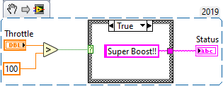

If Throttle value is above 100, add a status string informing the user they are in the "Super boost mode", like this:
Message 7 of 17
